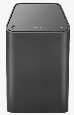

Tried michaelkenwa suggestion, no luck yet. One thing I did notice is my gateway is no longer 192.168.1.1 but 172.16.0.1. Any idea what that is about?

Normally the Xfinity gateways are a combination modem/router. When your Xfinity gateway was replaced, was the new device configured in bridge mode? This is usually done to support a downstream router like your R9000.
What is the model number of your new Xfinity gateway?
- trynkeepupAug 16, 2023Aspirant
Arris TG3482G
- FURRYe38Aug 16, 2023Guru - Experienced User
Thats a gateway router.
Your ISP Modem already has a built in router and wifi. This would be a double NAT (two router) condition which isn't recommended. This would be a double NAT condition which isn't recommended. https://kb.netgear.com/30186/What-is-Double-NAT
