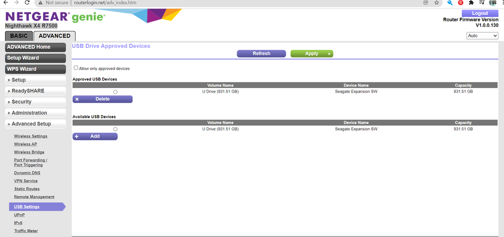

Hello,
I have recenly bought this as a secondhand router, I was trying to setup to use ReadyShare, I found it was not working as expected.
This is how I did setup my router.
I have a main router from that I have wired connection to netgear and exposed the WIFI.
Internet connections and wify are working fine. and then I have connected my 1 TB HDD to USB1 in the router.
In the Advance Setttings -> USB Setting - this option was enabled to Yes.
Enable any USB Device connected to the USB port -> Yes
And then Approved Devices section I can see my HDD shows I did choose to add it.
And then in the ReadySHARE -> Advanced section USB Storage (Advanced Settings) enabled \\readyshare and HTTP access options. but There is no Available Network Foldersinfo listing it there.
Rest of all the folders shows as disabled. what I'm missing here. I too tried factory reset. still no luck.

    I got it working. Forget to answer yes I did HDD formate to NTFS format it’s got working.

    Hi avmgan, please provide a screenshot of the ReadySHARE > Advanced Settings page. Also, what file format is your USB storage? Have you tried using the other USB port?
