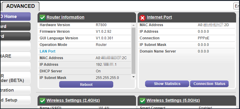

And here is the overview:

- Carsten_RJan 23, 2023Aspirant
and the overview of the router

The devices on my lan gets an ipv4 and ipv6 address, thats ok, but the R7800 gets only a ipv6 address from the ISP.
A FritzBox is working well, see attached image.The 'Modem' the R7800 ist connected to is a GENEXIS Gigabit a Gigabit-FTTH-Gateway.

Therein lies the heart of your problem. Your gateway is a combination ONT and router. The gateway is also providing routing functions on your LAN at the same time your R7800 is attempting to do the same thing. This results in a situation called double NAT. Not good. See here for background.
