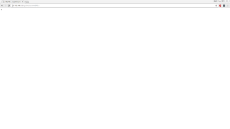

I tried using the http://[router-address]/cgi-bin/;uname$IFS-a link to see if my computer was affected with the bug. And I got the number 0 on the screen. Which makes me wonder if my router is affect...

Dec 20, 2016Aspirant
It's in top left corner.. It's the best picture I could get. I could send it thru imgur maybe it has a better image.
Anyways I sent a letter to the netgear secrutiy support email. waiting for a response. :)

All I can say is that the response you see is nothing like the screen I got when I tested my own vulnerable modem/router.
Unfortunately, I didn't grab the screen back then.
It would be useful is Netgear posted the sort of response expected from a vulnerable device. Then it wouldn't have to fend off a constant stream of similar queries.

- katedan19772001Dec 20, 2016Aspirant
Sounds like I'm safe. As long I don't show Linux on it. So looks like the 0 is considered an error. :) Well time to set up the router then!
- michaelkenwardDec 21, 2016Guru - Experienced User
That's my understanding too.
Now that I think of it, when my modem was vulnerable it showed something like the UNIX string mentioned. Now it just blocks me.
