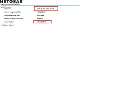

Hello friends, I have a Nighthawk X6 R8000, excellent router. But I have a problem that I'm noticing recently. I have 28 devices connected and the router in standby mode has a consumption of cpu1:34%...

What happens when you unplug everything from the router for 1 wired PC? CPU usage still high?
1 pc only,
CPU load
| CPU1: 17.45% CPU2: 19.15% |

- ChristianWisJan 29, 2023Aspirant
ok.. i was able to solve the problem.
The problem was not the router, but a PC with ubuntu and 5 docker images including transmission soft...
all right!
Thanks for the help
