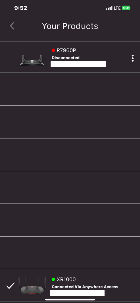

Be sure your using a good quality LAN cable between the modem and router. CAT6 is recommended.When your away from home, is the R8000 appearing in the Nighthawk app as being Disconnected?
Like my R7960P see here?
