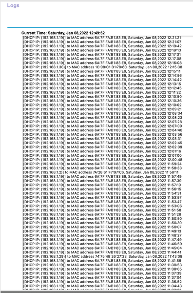

Nighthawk X6 R8000 Dropping 5G-1 at random.
The 5g-1 network is crazy flaky, it will regularly drop internet connection. During the "good" times streaming music will regularly stop for a few second before reconnecting. The Logitech Circle secu...

- TyrellTedJan 08, 2022Tutor
Firmware Version V1.0.4.76_10.1.82
In advanced/home it shows as channel "36 + 40 + 44(P) + 48", in wireless settings the drop down is on channel 44
I do have an external hardrive connected.

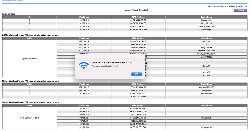

No better :smileysad:
Infact the 5g-1 is no longer showing up, even tried unplugging and waiting 2 minutes.
Devices that can see it, can't actually connect.
