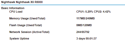

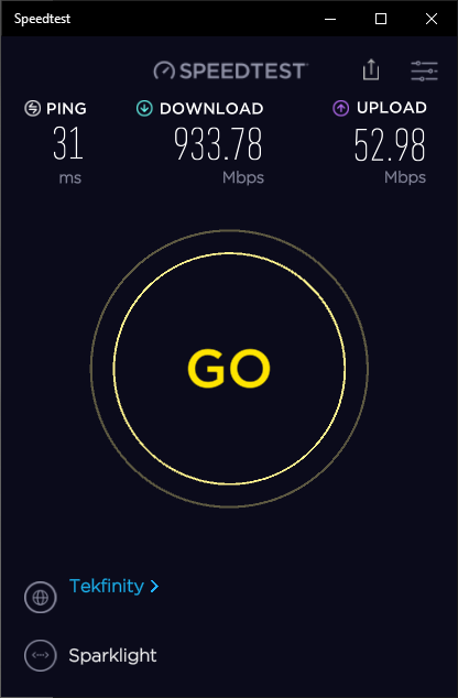

Day 3 of good WAN to LAN speeds:
- FURRYe38Mar 02, 2022Guru - Experienced User
Day 4 of good WAN to LAN speeds:
- FURRYe38Mar 04, 2022Guru - Experienced User
Day 6 and still getting good speeds:
This will be my last speed test.
Seems the v.76 FW suffers from the DNS issues seen by others. Though is not a show stopper, it's present on this version of FW. I've reverted back to v.62 as this version seems to work best for DNS for the R8000. This has been passed on to NG.
Good Luck.
