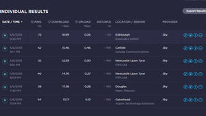

Nighthawk X6 R8000 providing slow speeds
So I recently bought a Nighthawk X6 R8000 to improve my sky internet. after I followed the instructions and set it up I ran 6 speed tests where I averaged 15.39 download speed and 0.24 upload speed, ...

Although I can now see the screen capture you posted, 'we' still don't know what exactly the SKY service is providing you? That and how close the router is matching that?
Are you just worried about wireless? You've never mentioned what the devices are nor the SSID on, or the speeds from the router AND from the SKY modem when in router mode and you connected to that?
