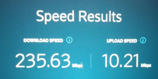

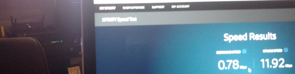

  • I did not have traffic metering enabled so that wasn't an issue, I went & disabled QOS. I then ran a speed test and got a lousy 0.78mbDn / 11.92mbUP, now I'm getting pissed, you can see how close I am to my router, there it is in the background. Then I remembered to reboot the router & got a sweet 235.63mbDn / 10.21mbUp. I ran a few tests w/ different browsers all getting over 225mbDn. I believe that was the issue it's much better now. Thanks for the help!!!
