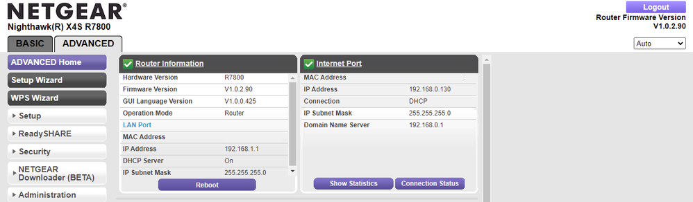

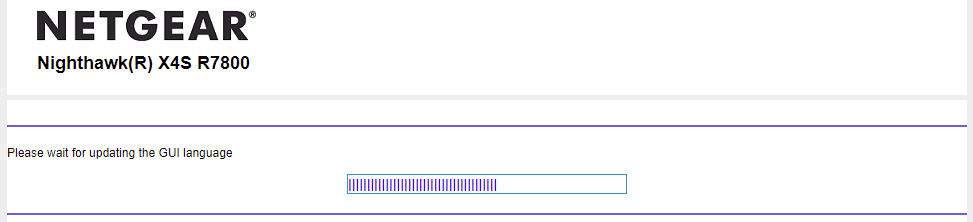

- dheMar 18, 2022Guide
Successful dual update of firmware (V1.0.2.84 to V1.0.2.90) and GUI language (V1.0.0.422 to V1.0.0.425), via the Firmware Update Assistant 🙂
Like aprayiii, no factory reset was needed in my case.
Many thanks for your support!
