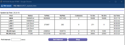

    What do the LAN Port connection statistics look like for the R7800?

        Your connection statistics show that your R7800 is happily connecting to the router a 1000 Mbps.
