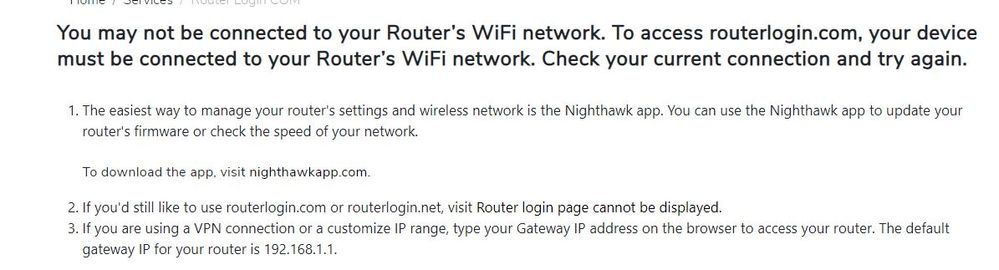

Understood. If I go to routerlogin.net i get a message saying that I am not connected to my routers wifi network. if i go to 192.168.1.1 it just spins. I am getting internet hardwired into one of the 4 ports off the back to my computer.
