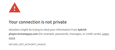

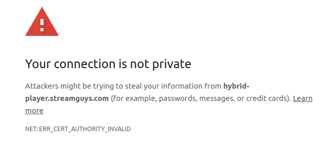

Our Nighthawk R7000 has be attached to a Nighthawk CM1200 modem for about a year with no problem. This past weekend, the ISP took their network down for what they called "a neighborhood upgrade". Whe...

This was one of my earlier steps. Intially after service was restored by the ISP I had no connectivity at all. After your recommended procedure, the router connected, but only made unsecure connections. There are some notes about "cert" being "invalid"(?)

Here is proof that I couldn't get a secure connection. However, shortly after making this screenshot, evrything started working! Just one more reboot sequence of modem>router>PC that I had done many times before this weekend. So far (3 hours later) everything remains online and secure.
