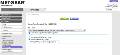

- GregGregMay 03, 2022Star
aglaesemann
I have similar problem in previous firmware version.
Currently, to minimize router problems, I reset the settings to default before each upgrade. After a upgrade, I also reset the settings to default and set everything again.
Below my settings (working properly):tempus1.gum.gov.pl - is Poland government time server.
Try to reset router
Set NTP with properly name of NTP server
It worked for me. - aglaesemannMay 16, 2022Aspirant
