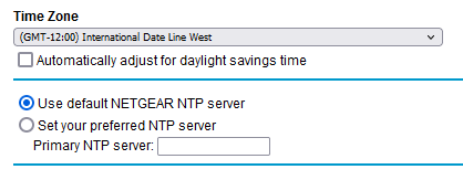

Hi sorry, Don't have a solution, but in as far as the inability to change the timezone; I have the same problem with my r7000p.
I had little choice but to upgrade to the latest firmware V1.3.3.142_10.1.75 Hotfix. (to address a potential circle daemon exploit).
So I wondered when you noticed this and what firmware were you on?
In my case, the router NTP timezone is 'stuck' on what I guess is the default timezone.
I have tried to change it a few times. I hit 'apply', router goes through 'updating'... and when the screen reloads; nothing has changed. Same as you.
The interesting thing is that Current time being displayed is correct, even though the timezone it seems to be stuck on is 22 hours behind mine.

- FURRYe38Oct 28, 2021Guru - Experienced User
This happens on different browsers?
Has a factory reset and setup from scratch been performed since last FW update?
