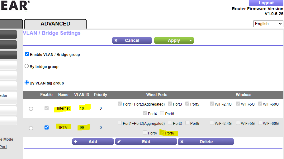

  • schumaku's avatar
    schumaku
    Just one VLAN tag group is required for Internet, assigned to all ports and WiFi. Instead of VLAN ID 10 use the VLAN your ISP defines. The second entry (here marked IPTV for VLAN 99) and assigned to port 6 in my old example isn't required in your case and just shown as an example for ISPs providing dedicated tagged IPTV VLANs.
