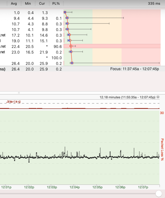

https://www.duckware.com/tech/solving-intermittent-cable-modem-issues.htmlOut of curiosity, I plugged a brand new M1 Mac Mini into the modem/router using the ethernet cable and gave packetlosstest.com a shot. According to that site, there are zero dropped packets, but 44% were late (1321/2999). Average latency of 53, 6ms jitter. I can see that some packets had response times upwards of 177ms, while the best ones were 46ms. I turned off wifi radios prior to testing, ensuring all devices were disconnected. I also noticed that there is no known ISP service box from what I could see, as the coax cable that enters my home runs up the side of the house and is then suspended in the air, connecting to a utility pole. I tried another coax coupler in case that was the problem, but no change. I checked again for any splitters and did not find any, nor did I find any cable line issues after performing a thorough physical inspection. Confirmed that the coax cable up to the modem is a high quality RG6 cable, and did another one-minute power cycle on the modem. I think I am running out of ideas here.

A pingplotter trace with my wired PC had essentially the same results except I was seeing packet loss at the first hop as well. The cable is a CAT6. Here is an updated result with the Mac. I cannot imagine that the 330ms time to the last hop is good.
