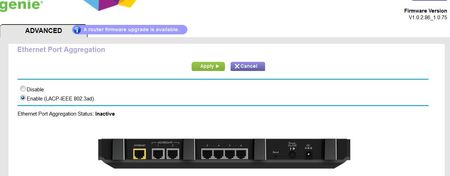

I thought I posted it, so please if someone finds it somewhere else it is likely my mistake. To the point. I am under impression the port aggregation should say active if connection to QNAP NAS ...
- Apr 10, 2018
Ratz wrote:I just know 1 + 2 adapter in QNAP are sharing same IP address. This is likely incorrect
as it only supports if one adapter fails, the other takes over.
No, perfectly correct. The bonding adapter does hold an IPv4 address, the individual ones don't.
Ratz wrote:
I tried with two different IP addresses for balance load but I had no Internet Access. I think I will try to assign a static address for both adapters.
Impossible to configure on QTS - and that's OK. In case your NAS can't reach the Internet, check if you had fixed the interface to a different NAS interface before in the Default Gateway selection settings.

Ratz
Apr 10, 2018Guide
Port aggregation works just great. Thank you all for the input.
In QNAP NAS I did choose right setting which is:
Supports Active-Backup, Balance-tlb, and Balance-alb
