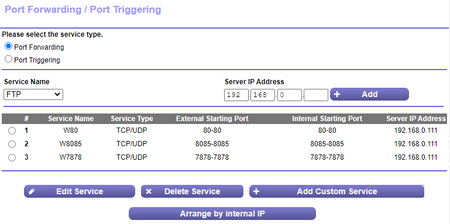

I'm a networking novice: please be patient. I've looked at several similar threads (1960181, 1517696, 1556128, etc) for this device and other modems/routers and have been unable to resolve my issue....

> [...] Below is my forwarding configuration within the modem.
I can't (yet) see your picture. In-line images must be approved
by a moderator before others can see them. The time required varies.
Attachments have no such limitation. Of course, attachments have their
own one-per-message limitation. In the mean time, copy+paste is your
friend.

Sorry, I was unaware of that limitation. I've included an image with a few screenshots together. The port forwarding configuration is obviously marked #1 in the attachment, the other marked bits are mentioned later in this post. Transcribed example:# Service Name Service Type External Starting Port Internal Starting Port Server IP Address 1 W80 TCP/UDP 80-80 80-80 192.168.0.111

The port-forwarding rules look plausible (if you want those ports).
