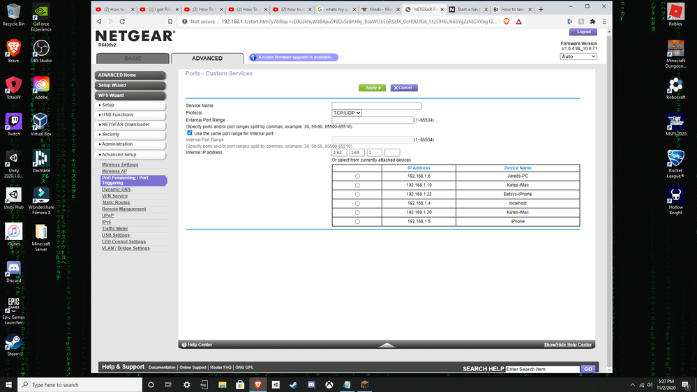

Port forwarding on R6400v2
 so today I was setting up a minecraft server and when i proceeded to port forward it i got this, down below.  there is no way to change the external starting point or ending point and no way to set i...

- StephenBNov 03, 2020Guru - Experienced User
I don't have this particular router, but I haven't had trouble with port forwarding on a wide range of Netgear routers.
The only field that appears grayed out is the internal port range, and that is simply because you checked the option to use external range internally.
What exactly can't you set? Have you entered something in the Service Name field?
What port(s) are you trying to forward?
- AredjayNov 03, 2020Aspirant
Im wondering how to even set it up, when my friend trys to join the server it doesnt work, with the local and public IP
The service name is just descriptive - Minecraft should be fine.
The port for Minecraft is 25565.
The local IP address should of course be the local IP address of your minecraft server. Ideally you'd reserve that address -= see page 114 here for instructions on that: https://www.downloads.netgear.com/files/GDC/R6400/R6400_UM_07Aug2015.pdf
Once you've done that, your friend would connect to your public IP address. The problem with that is that your ISP will change your public IP address w/o warning. So you should also register for a free DDNS account (see page 86 of the above reference). Then your friend would connect to the DDNS name, and the DDNS cloud service would resolve that name to your current public IP address.
