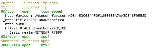

Port forwarding on R7000 not working (fiber & VLAN)
Hi all, Last weeks I have been puzzling with port forwarding on a R7000. I hope someone can help me out here. Setup: Fiber (1 Gbit) connected to Optical Network Terminal (ONT) little white...

The R7000 gives the following logs when I am trying to setup the DDNS service on the NAS. So it's knocking at the door, but no answer.
[WLAN access rejected: incorrect security] from MAC 00:05:CD:AA:24:0A, Wednesday, Mar 02,2022 11:30:37
[WLAN access rejected: incorrect security] from MAC 00:05:CD:AA:24:0A, Wednesday, Mar 02,2022 11:29:22
[WLAN access rejected: incorrect security] from MAC 00:05:CD:AA:24:0A, Wednesday, Mar 02,2022 11:28:07
[WLAN access rejected: incorrect security] from MAC 00:05:CD:AA:24:0A, Wednesday, Mar 02,2022 11:26:53
[WLAN access rejected: incorrect security] from MAC 00:05:CD:AA:24:0A, Wednesday, Mar 02,2022 11:25:38
[WLAN access rejected: incorrect security] from MAC 00:05:CD:AA:24:0A, Wednesday, Mar 02,2022 11:23:19
This reaction makes sense, as the port still has the "filtered" state.
So why can it not be opened...

Hi all,
Thanks for helping out. I found the solution. The problem was on my NAS (the DNS server on BOND 1 was false). After giving the NAS a static DHCP and on the NAS set this on ' automatic' the connection was resolved.
After all it was a rookie mistake. However, the learning is that if your port scan gives a state FILTERED or STEALTH, the port is actually open, but the application on the internal LAN is not correctly configured.
Cheers
