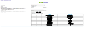

4IDp8

>I have tried port forwarding inside of the main router using the "88.90.##.## address, but it don't seem to work
>Even if the server is up and running while I test it, it says: "Connection timed out"
I copied some information from "Lan hosts" this is my computer
Static DHCP
[ ] (Should i toggle)
Name for Computer
Desktop-[...]
IP address
10.0.0.37
MAC (ASUSTek)#############
ConnectedEthernet/2
Rate100M/full
Signal-
Uptime
Serial numberUnknown
Connected toRG
"Here is the information that comes up when I type ipconfig in cmd:
I replaced ipv6 and other stuff I don't know what is with [...]

> Minecraft server tcp/udp: 25565, 192.168.1.10
Don't hide any of the "192.168.1.z" addresses. What's the (LAN) IP
address of your Minecraft server system?
