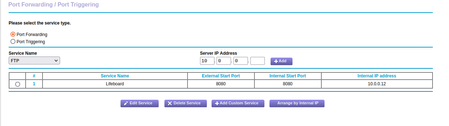

I am having an issue with port forwarding. I have two laptops running off the same Netgear router (@10.0.0.1) - one at 10.0.0.5 and the other at 10.0.0.12. The apache server on 10.0.0.12 is listening...

> Here is how I have this set up in my router
Looks plausible to me.

> But when I try and connect through my router at 10.0.0.1
> (http://10.0.0.1:8080/test), I get [...]
Seems as if it ought to work, doesn't it?

Relying on my notoriously weak psychic powers, my first guess would
be that you're using a D7000v2, whose firmware is defective, in that its
doesn't do NAT loopback (on which you're relying in such a case).
To what is the WAN/Internet side of this mystery router connected?
Did you choose the "10.0.0.*" subnet intentionally for some reason or
other, or did the router choose it because it saw that its WAN side was
connected to a "192.168.0.*" subnet, or what?
If the D7000v2 hypothesis is correct, then you might try accessing
your server from a system on the WAN side of the mystery router (using
the WAN/Internet address of the mystery router in the URL).
