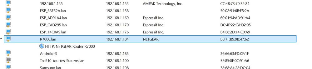

Have you logged into your orange router to find out what IP address its assigning to the netgear?
- gortsilasDec 13, 2021Aspirant
Hello, thanks to reply me.

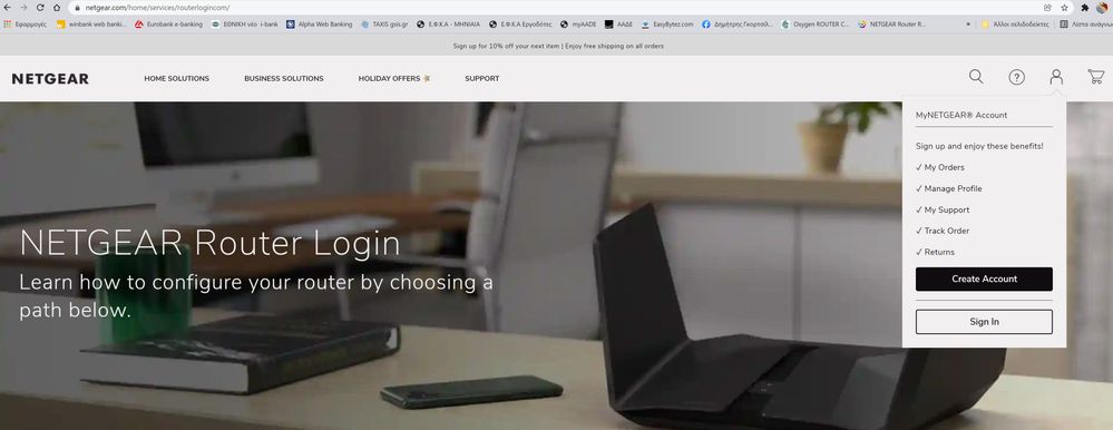

Yes , like a photo 1 ( 192.168.1.184 ) but if Ι go to this address, all it does is a new interface, without to give me options to settings τhte router (photo 2).
