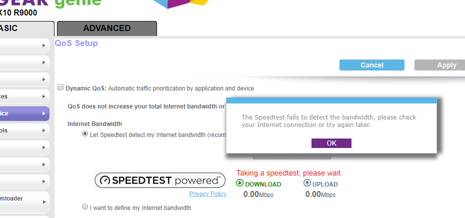

QoS Speedtest Failure on R9000 X10
First time here. Be patient.
Firmware V1.0.4.12
I have a problem that seems unresolvable with this new router. 3 hours of troubleshooting with tech support, couldn't arrive at a solutio...
- Oct 27, 2018
:Fix this, Netgear!
Thanks schumaku Perhaps I should have just jumped in here from the start?
I'll continue to use the manual entry method with QoS. Until....
It started with a quick call to tech support with a case number, then the grueling investigation and RMA. We did go back to the previous Firmware version, with no success too.
And odd situation occurred with the first few questions Netgear installation setup walks you through as it identifies the router connection to the Internet. It seemed to identify either another router or gateway. None that I'm aware of. Just the Arris modem and the greater ISP service out to the Internet. I wondered if the ISP had something the setup recognized? Something "out there"? It kept asking how I want to handle that device? I guess positively choosing the R9000 as a "router" of choice, after floundering around clicking menu options.
The replacement R9000 arrived. Within 10 minutes of setup, the very same odd identification of seemingly something else already in the network, as well as the QoS failure result. Could some residue leftover from the R7000 been the issue? I'm always cleaning out browser cookies. Just wondering, wondering what setup saw? I mentioned this to tech support first time around. Of course they asked if I also had a router/modem combo or just a modem? Just the latter
I called tech support again for the second R9000 to give them feedback after calling the cable company out. The tests done outside and inside the house were fine. 50 down, 10 up has been adequate for our networked house (TIVO, Arlo cameras, several networked computers). His recommendation was live without Qos. I don't believe I'll get a bill. He did try to upsell me on WIFI repeaters for better connectivity. That's not my problem.
The feedback call to Netgear support had them wanting to start a troubleshooting process again. No way! I'll live with it. "Just know both R9000s have the same problem".
I'll treat this as solved. Cheers

In the first iteration, this looks to me like some URL, API, API key, or license key they use with speedtest.net are out of service. The same happens here on a (newer, unreleased, test) firmware here on my R9000, too.
Anyway, if you have a "low bandwidth" Internet connection, and insist in using the QoS system, the best alternate approach is to input the nominal bandwidth from your ISP contract for the up- and downstream accordingly.
Can't see why this requires a router replacement or hours on the support line (gee, this sows the quality of the support btw.). Evaluating and writing this post takes me about a minute or so. ChristineT - what's up with your support people?
Ok, here for Alex in a second iteration, and spending one minute more enabling the debug telnet access, and peeking around does show this:
root@R9000:/# cat /tmp/ookla_speedtest_result
serverid: 3821
isp: Swisscom
latency: 8
upload: 991085
New conclusion - somehow the router firmware does fail to read the result. Ohdear ohdear Netgear..... Altsai what's the matter here?
Fix this, Netgear!
PS. Very patient with Tilghman, welcome to the Netgear Community by the way. Much less patience with Netgear.

New firmware update 1.0412 has caused my perfectly working router to stop speed test, Wont let me enable Qos ] and my upload speed is from 50 mb down to 6 Mb tops
Apprently the firmware has issues. My Isp sent people out saying its the router.They have had numerous reports on the Newer netgear routers not working with there new high speed systems. I have the router for like 2 months and it worked well till firmware update. I also see others complaining about the same issue. So is there a fix yet ? 400 bucks and a useless router . Had 5 adc5200 go bad as well and Netgear gave me this as a free upgrade. Back to issue of not working correctly. How do we fix this consistnet problem
