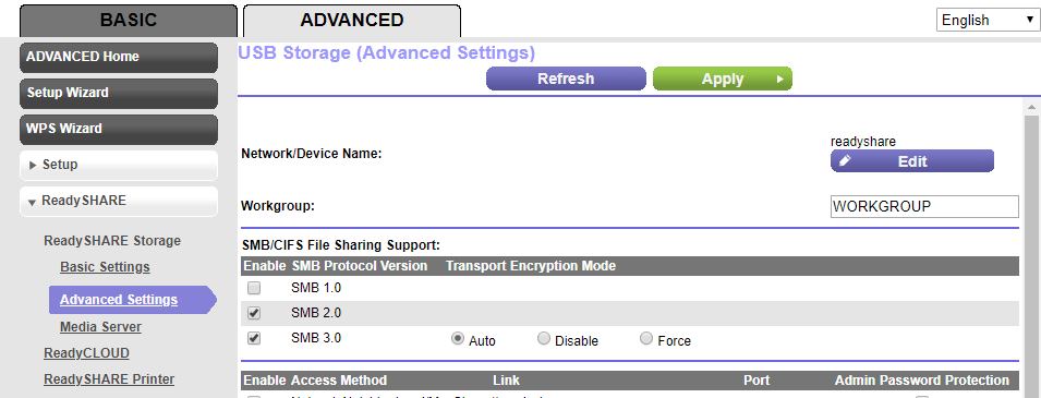

And smb1 needed disabled or fixed to protect against wannacry and the like.The R7800 has got SMBv3 support since R7800 Firmware Version 1.0.2.36 - and most likely a SAMBA update at the same time - so one might assume it's a version no longer vulnerable in place. Does ReadySHARE not offer a protocol selection so SMB 1.0 can be disabled?
Edit: This is what I had in mind (different model here):
