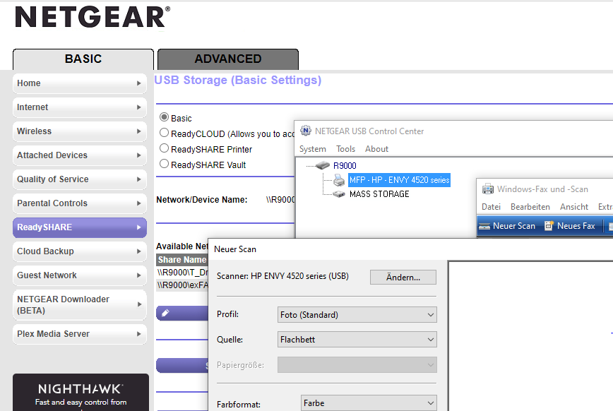

    The Netgear USB Control Center does allow to manually "connect" using [Connect for Scan/Fax function] - the connection should be retained until [Disconnect] is used.

    Once the MFC is recognized over the USB-over-IP, the printer software can be installed and configured to use the virtual "USB" port on each local computer. When connected to the router, the USB Control Center will show the connection established and identifying the printer make and model. The functionality is similar to a locally USB device plugged and recognized device, fully fledged printing, scanning, fax, and whatever function will be available - in my experience without manually allocating it using the utility.
