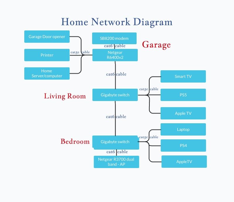

I have the R6400 v2 router and the SB8200 modem on 500Mpbs internet. My speeds are terrible wired and wireless. Using my iphone on the 5ghz band i can get around 300 down. Wired on the PS5 or my smart tv i am gettung under 100 down.  Is this router junk and should i look for something else? I am using cat6 cable between main equipment and cat5e to devices.
diagram - https://ibb.co/rHT2tpX

      This morning before i left for work i reflashed the router to 1.0.2.52. I was on the current latest firmware. But i have not reset the router after the firmware.  If you glanced at the link for my network diagram, my son has his laptop wired and he did get 500 down. Other things like the PS5 and smartTV couldnt get anything faster than 60 down.

        If the laptop is hitting 500mbps, then I'd be trusting of that. Most tv's aren't equiped with gigabit connections since streaming 4k only takes 25-40mbps. Its the rare tv that has a gig connection as its not needed. So it might just be an issue with the ps5.

      I did look at your diagram and I'd recommend trying to connect the ps5 directly to the r6400 and see what speeds it gets. Every step adds a chance for an issue and you know the router is getting full speeds if the laptop can pull 500mbps.

        Ok after re-routing some cables and changing out some cables i think I'm back in business. I'm still running the old firmware but the ps5 is getting 500 down along with the iMac and my sons laptop. iPad Pro and iPhone on 5ghz band is getting any where from the high 300s to low 400s.
