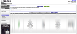

R6700v2 Cannot Turn On Access Control
I'm running outer Firmware Version V1.2.0.92_1.0.1 (latest) on my R6700v2 and I cannot turn on access control. I select "Security" then "Access Control" and check the box to "Turn on Access Control" ...

The error message under the frowny face is "internet-router didn’t send any data".

What speeds do you pay for? we usually don't recommend Access control if you have speeds >250mbps as it can slow it down on the r6700
- bmkantorNov 12, 2023Tutor
My Internet speed is 300 Mbps Internet Service. I tried both Edge and Chrome, and they both behave the same way.
- plemansNov 12, 2023Guru - Experienced User
Parental controls, access controls, traffic monitoring, can all drop speeds if you're over that 250mbps as the processor needs to inspect the traffic and it can't keep up above those speeds.
Unless you really need access controls, I'd leave it disabled so you can use your full speeds.
