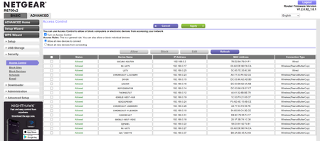

R6700v2 Cannot Turn On Access Control
I'm running outer Firmware Version V1.2.0.92_1.0.1 (latest) on my R6700v2 and I cannot turn on access control. I select "Security" then "Access Control" and check the box to "Turn on Access Control" ...
