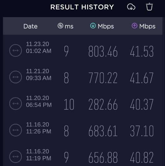

Review of my connection...I have Comcast GB connection, with Netgear CM1000 Cable modem DOCSIS 3.1.
I checked for new firmware. Downloaded V1.0.4.102_10.0.75. After factory reset, I updated with the firmware file, and tested speeds with Speedtest. Download speed is 803.36 Mbps, Upload 41.53 Mbps.
Steps followed taken from user from this same thread:
Installed newest firmware
Factory reset all settings
Enabled QoS applied settings (Downstream + Upstream)
Disabled QoS (Downstream + Upstream)Hope this helps! Seems like Netgear may have fixed the firmware issue. I'd like to hold off on final, FINAL conclusions, but I'm reluctantly hopeful.
