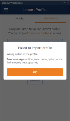

Ok... downloaded "OpenVPN Connect" and found the advanced setting...
but now I cant import the profile?!?...

- abdseaNov 05, 2023Guide
can you post your profile trying to import? please blank out your domain name or other private information. The option file contains error without looking if i have to guess
proto option has some invalid characters or some information. Proto can only be TCP or UDP please check that. For most VPN configuration you need to have this set to UDP so can tolerate some errors.
