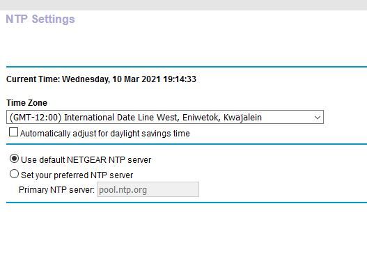

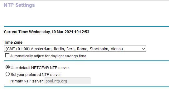

My NTP settings:

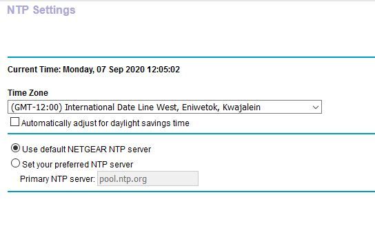

These are the settings when I have connected to the router via WiFi with the Nighthawk app and log in to the router again:
When time is resynchronized, or after reboot, it has been adjusted to wrong time zone:
Even if I use an preferred NTP server (pool.ntp.org) the same thing happens.
