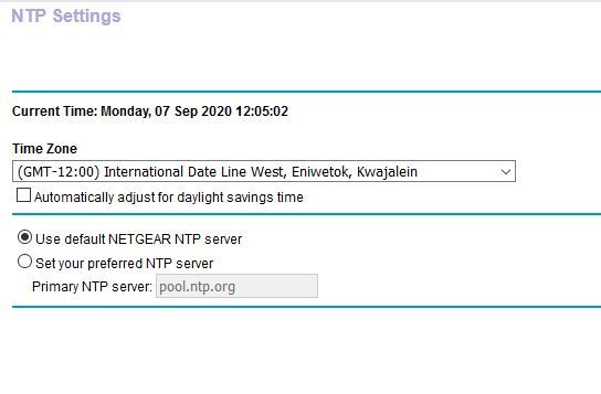

- Dinky2534Mar 10, 2021Star
When time is resynchronized, or after reboot, it has been adjusted to wrong time zone and wrong date:

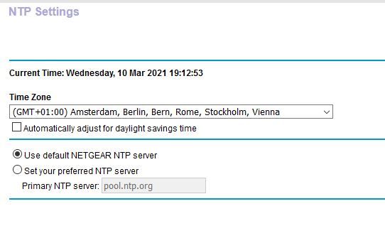

My NTP settings:

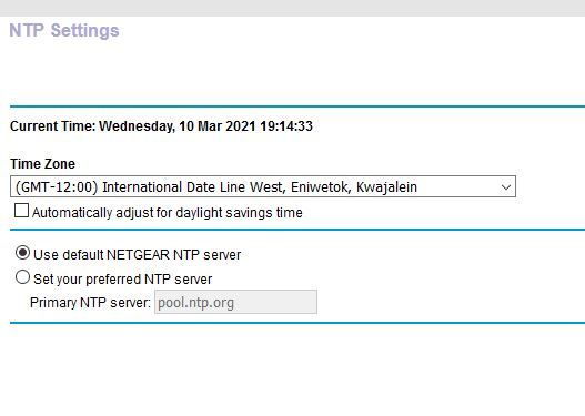

These are the settings when I have connected to the router via WiFi with the Nighthawk app and log in to the router again:
- GrandFlandersOct 30, 2021Tutor
THIS, NETGEAR - ALL OF THIS - FOR MONTHS.My NTP settings:
When time is resynchronized, or after reboot, it has been adjusted to wrong time zone:
Even if I use an preferred NTP server (pool.ntp.org) the same thing happens.
