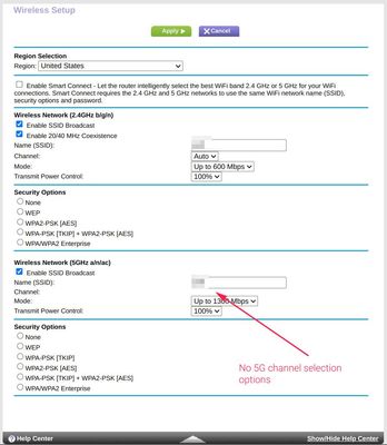

- brisk5181Jan 22, 2022Tutor
I have encountered two problems with this version.
1. After router is reset to default setting, I can get fast wifi and lan, but if I power it down then up again, wifi 5 gets really slow, unless I factory reset it again without powering it down.
2. Unable to set the 5G channel. The channel select just doesn't exist.
The worst part is, I cannot go back to previous firmware from UI.
Any suggestions?
