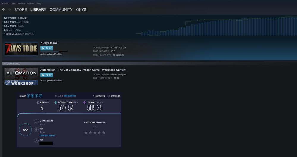

Everything is back, as before with a bonus - page opening/loading is more responsive on browser than my older firmware (year 2017/2018 probably). Still have to test, maybe it also helped with the IPTV. Will keep this firmware forever :)
Screenshot several minutes ago:
Thanks a lot!

- OkysDec 15, 2019Guide
plemans wrote:
Steam isn't a reliable indicator of speeds because their speeds can changed based on the load on their servers.
I'd try http://www.dslreports.com/speedtest
or http://speed.googlefiber.net/
These tend to be able to max out fast connections and be fairly reliable indicators of speed.
DSLreports tested to EU and speed is lower, but still very good.
Here is the result: http://www.dslreports.com/speedtest/57484773
googlefiber was testing to Atlanta, which is US, and was 205Mbit down/107Mbit up.
I'm from Latvia, EU.
Anyway, it's now better than before. :)
