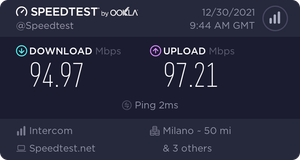

R7000 Issues after factory reset - IPv6 - Speedtest/QoS - Remote management port - DynDns
Hi, I have the Netgear R7000 Router WiFi Nighthawk, Dual Band AC1900. I've upgraded the firmware to version V1.0.11.128_10.2.112 and then I have reseted my router using the button in the admin page ...

> QoS and Speedtest
Same situation after reset.
The list of connected devices is also unreliable.
Same ip with different mac address (192.168.1.8)!
192.1681.17 (the extender) not in the router list, yet I connected to it from a computer connected by cable to the router. Other devices that are present in the connected devices from the extender and not in the router's list.
If the router can't show the correct list of devices connected to it and can't even measure the correct bandwidth, what does it do with the QoS rules?
