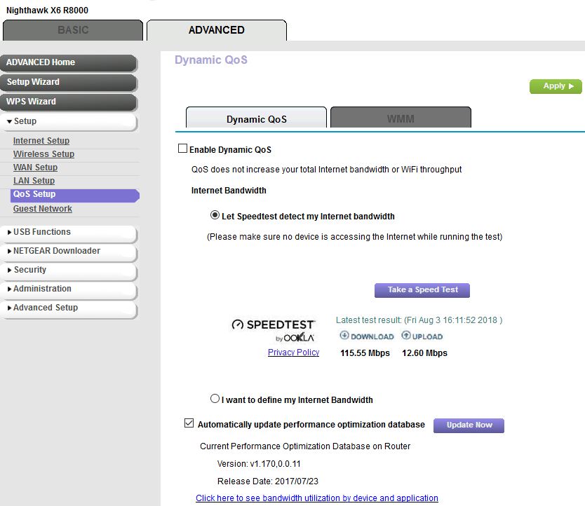

I recall, but could be wrong, someone had a similar problem and solved it a very unusual way.
Look at the QoS tab. That is on the ADVANCED, SETUP tab in a browser running Genie and logged into the router.
In the middle is a SPEED TEST. Run it, it should find your speed just fine. That was the 'fix' I recall? If there is NO value there for speed or it is low like you are getting you could have found the cause for low speed. Some have claimed even with QoS off that 'rules'.
Hope this helps.... and if it does show a low speed after test, well, I don't know what to tell you.

That only shows up when QoS is enabled, and it's the speedtest.net one, as I recall. I have run that one from their website...the xfinity one from speedtest (which is inaccurate, as it only tests to Comcast's server within speedtest), and at DSLReports.com -which is the best one to use.
I have read that, if you enable QoS, it will booger your speeds, and that at Gig speeds, it's unnecessary anyway, so yeah...welcome to my world :o) Thanks for the reply tho...

Yes, true... but it seems that 'some' speed is set internally some say. That limits you. Enabling Qos, testing the speed and applying clears that. Then disable QoS and apply.
I did that one first setup, and that test always has appeared for me, and I can run it, even with QoS disabled.... see Capture on right.
