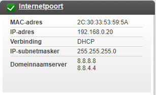

- RvreeswijkApr 05, 2020Aspirant
ah thx for the reply!
So if i understand it correctly, My internetport IP-adres and my IP that i find on the internet (whatismyipaddress.com) has to be the same?
If this is true, i will call my ISP tomorrow and ask if they can set it good?
- antinodeApr 05, 2020Guru
> i find on the internet (whatismyipaddress.com) has to be the same?Yes.
"192.168.0.20" is a private address, and that's a problem. But
that's not an address which I would expect from an ISP using CGN.> [...] Connected to what?
Still wondering. To what is the WAN/Internet port of the R7000
connected?If your R7000 is connected to some other router, then the fact that
you have more than one router is the problem. If your only router is
the R7000, then the other router must be at your ISP.- RvreeswijkApr 05, 2020Aspirant
[...] If your only router is the R7000, [...]
Yes, the r7000 is the only router i got, its connected the the modem that i received from the ISP. I hope this is your answer haha. I will contact my ISP for another IP adres that is open. Thx for your help! I hope it will soon be fixed.
