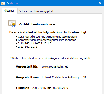

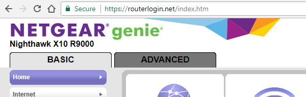

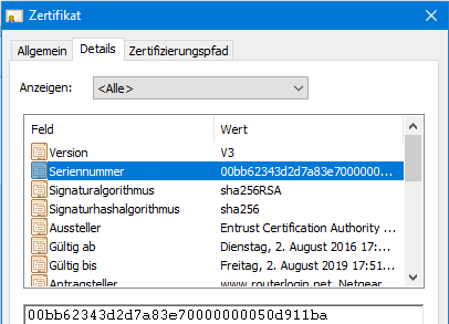

I'm not. Because I know that the most critical information in this "secure" connection is not secure enough: My router private key is well known. And so is the Entrust signed certificate. All similar routers out there make use of the same private key, the same certificate serial number, and the very same fingerprint.
This "green" https connection is not any better than the plain text http connection on my trusted network. But it's OK because it's my private network again. Figure.
