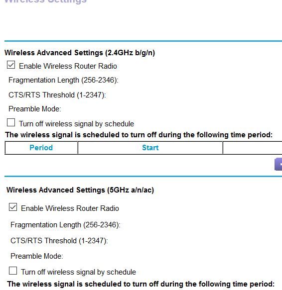

Hi All,
Access the UI and make sure to enable router radio.
https://kb.netgear.com/24101/How-do-I-enable-or-disable-the-wireless-radios-on-my-Nighthawk-router
If still the same, reset the router.

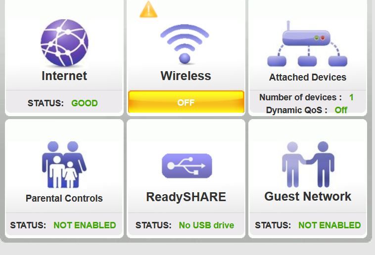

- curryfoundationJul 25, 2017Initiate
I cannot see the wireless SSID. I've tried searching for the SSID on my laptop, phone, and xbox one to no avail. I just factory set madhatter, used original settings, wireless is still off. I then went to routerlogin.net and it's telling me the wireless is turned off.
Even though the radios are set to be enabled, it still says wireless is off. The kicker is that, the hard wireless button is lit up like a christmas tree informing me that wireless should in fact be on.
