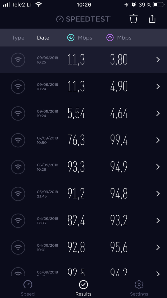

- CreatiumSep 09, 2018Guide
Did a first round of testing. Speed still drops. See image below (newset tests are on top). Will do a second round now to see if maybe one of my devices is triggering this problem. Will post after that.
