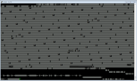

R7000P bricked tftp not possible
After a firmware update went bad I am unable to reset or reflash my router. I has a USB-TTL cable connected to the internal header but what is coming back looks like complete jibberish, can an...

Worked it out. Pin connections from left to right with the router facing you (serial header on front right of board) should be Tx, Rx, Gnd. 4th pin (most right) not connected. Data comes through fine with 115200, 8-N-1 settings

Hopefully the screenshot is attached this time rather than embedded.

Just to add - if you are using the TTL cable to flash back to stock firmware then once the process has completed you will need to remove the static IP from the ethernet connected computer else you will only reach the first setup page (auto update and data gathering) before moving onto the routerlogin.net page which will not load. If you have the serial connection still up you will see "handle_genie: don't know how to process url". Make your static IP a dynamic one and reconnect and all will be good. That one had me spinning my wheels for a bit before locating this.
