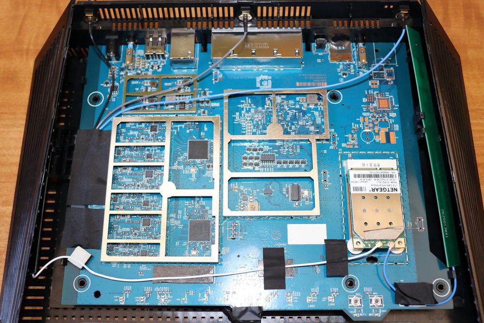

    To the left and the right sie of the router - image borrowed from https://www.redeszone.net/netgear/nighthawk-r7100lg-4g-lte-ac1900/
    Elnero wrote:
    4. or do you have other advise.
    Once the warranty is over or it can be considered obsolete, happy DIY, drilling machine, get two adapter cables RP-SMA (mounting in a hole) to UFL/U.FL/IPX/IPEX RF A (from an old scrapyard WiFi router for example!) - consisting of e.g. Pigtail, 1.37 mm cable with IPEX/U.FL® connector and SMA cable jack, bulkhead mount, 1.37 mm cable, crimp, add some nice antenna like LTE Antenna, OMNI directional for all LTE bands, w. two 5m SMA. Talk to WiMo - they are great(!) and will assist with cable crimping. Dont make the internal cables longer than required, see the examples from Netgear!
    But now - it will help to some extent, but can't make wonders - the loss in the cables and connectors will eat away a good part of the antenna gain. Still better than in a RF "insulated" Faraday cage.
