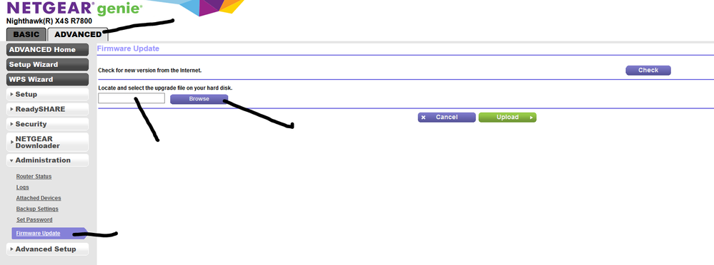

How to re flash firmware
I downloaded latest one.- mondenathSep 02, 2017Prodigy
Go to advanced tab and before last administration upgrade
