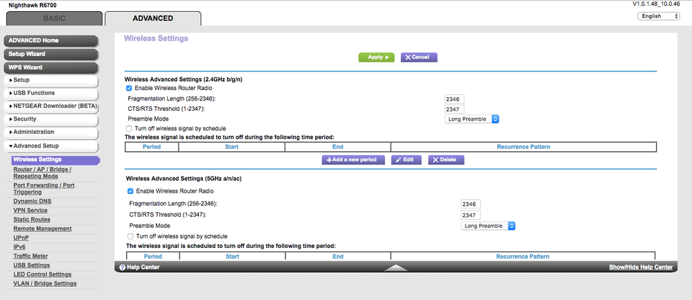

R7800 2.4 GHz is not working. (LED light not blinking)
Hi there,
2.4 GHz seems not working.
I remember I have seen 2.4GHz a while ago. My partner might have disable it before but I tried to turn it on http://www.routerlogin.net/start.htm. It i...
- Jun 24, 2018
Thanks for replying. Didn't expect anyone would reply so promtly.
Actually find out that 2.4GHz was disabled for Chromecast related issue. Now I brought it back in ADVANCED settings on and the light is blinking again and working fine.
I might worry about the Chromecast issue later.... eh... technologies should be compatiable!

KK_99
Jun 24, 2018Aspirant
Sorry. It's R6700.... I don't if I can edit my original question to avoid confusion....
I updated last night to V1.0.1.48_10.0.46. I just noticed it might be problem of firmware according to this post: https://community.netgear.com/t5/Nighthawk-WiFi-Routers/2-4Ghz-stops-working-5Ghz-fine/td-p/1452075
I might try to roll my version later.
