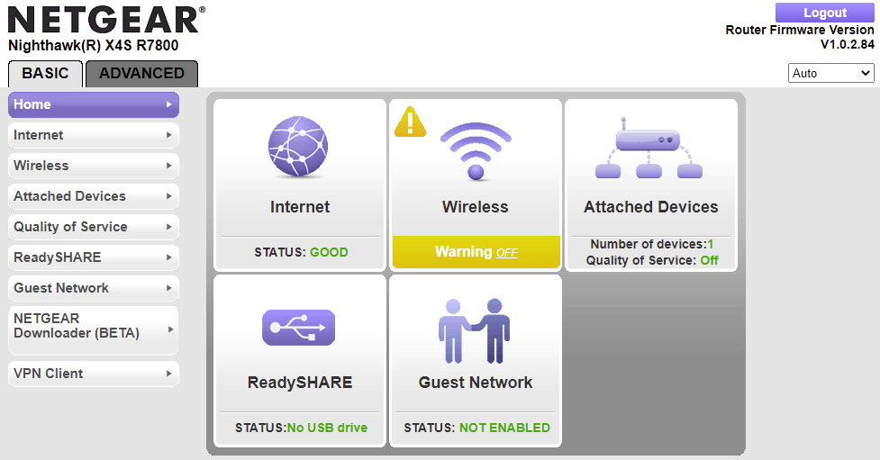

Ok emulated a brown out with just the router and it came back on line.
Then emulated a brown out with both ISP Modem and router at the same time then back ON after 30 seconds. The route came back online fine and allowed me to type and post this:
