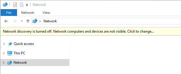

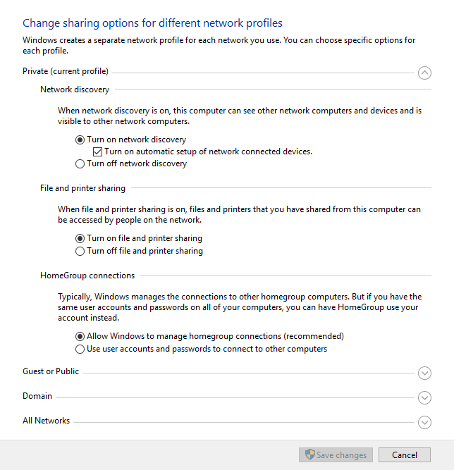

Hi IrvSp,
I attached the screen shot on Network discovery is turned off and more.

OK, now that I see your screen capture(s) you've got one problem you will hit soon if not already.
MS, in its keeping YOUR best interested at heart (pun intended) has made changed for the Spring Creator V1803 update. No more Homegroups, which it appears you are using. I am NOT. I use normal TCP/IP network sharing. I little more complicated between PC's as credentials are need on all shared PC's for permissions.
See these 2 articles:
https://support.microsoft.com/en-us/help/4091368/windows-10-homegroup-removed
the fix:
https://www.windowscentral.com/how-share-files-and-printers-without-homegroup-windows-10
Also, see my screen capture on the right, ALL NETWORKS should also be set.

Thanks for pointing out my screen shots are about Homegroups. If MS discontinues it, I am most likely better off not to fight that. My All Networks is set as in your screen shot, but I guess that's also part of Homegroup, right?
When you say "normal TCP/IP network sharing." Is that what the "fix" link is about? If yes, I also tried that but doesn't work - my laptop still says "Network discovery is turned off..." like in the 1st screen shot.
