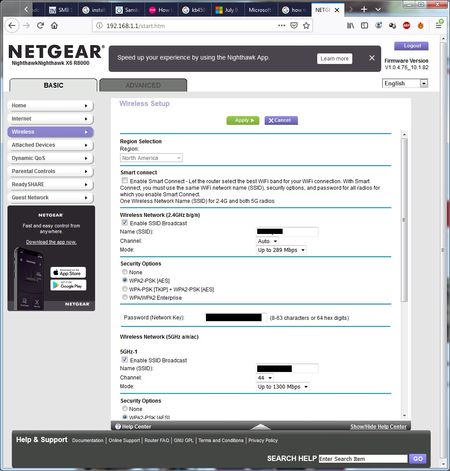

R8000 all wifi lights and signals turned off after update *solved*
I got update V1.0.4.76_10.1.82 and immediately lost of my wifi signals. No changes or reboots would restore the radios, and they remained off despite all setting indicating they should be on. The Da...
Dec 28, 2021Guru - Experienced User
Try a full on reset using the reset button in back and press it for 10 seconds then release. Walk thru the setup wizard with a wired PC and web browser. Router should come back to full ready.
